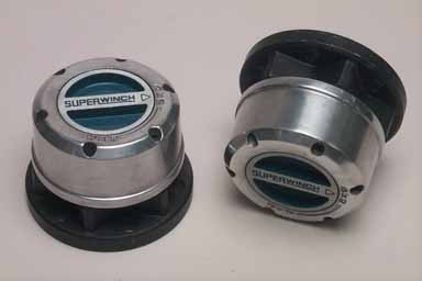

Il y a aussi les superwinch de chez Calmini :
CALMINI Superwinch Manual Locking Hubs -These are the perfect replacements for worn-out factory hubs. Hubs will replace either existing manual locking or automatic hubs. High quality steel cased hubs are precisely machined & assembled. The mechanism is fully sealed from water, dust, and sand making it virtually maintenance free. Features self lubricating cam design. Limited lifetime warranty. We recommend to install manual locking hubs on all lift kits over 2" in height. Sold in pairs. Fits 91-03 17-spline Rodeo/Passport.Part Number IP-24533
Price $ 129.95
Bref, voici quelques pistes à étudier ....
