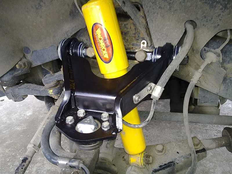

I have done Calmini-like upper A arms myself. Here they are:
+ 2 inch TrailMaster lift
+ IronMan trosion bars
+ 31'INTERCO TrXus MT
+ Waiting for these to arrive:
These are for Chevy 1500HD 2000HD 2500HD. Fox #980-02-359-А
Will fit almost without modifications - just bottom mount must be corrected a little.
